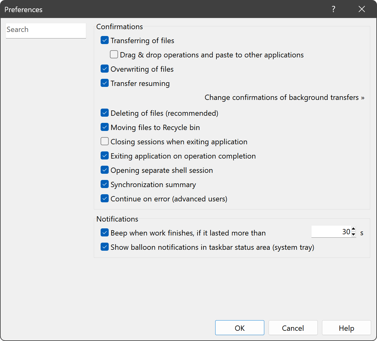

Preferences Window Empty
When I open WinSCP version 6.5.1 (Build 16311 5/5/25) and click on preferences, it brings up a window that has options on the right no other settings. Please see attached.
_________________
Life is a lemon, and I want my money back!

Re: Preferences Window Empty
What is your monitor setup? Do you have multiple monitors? What scaling? Does it help, if you restart your computer?

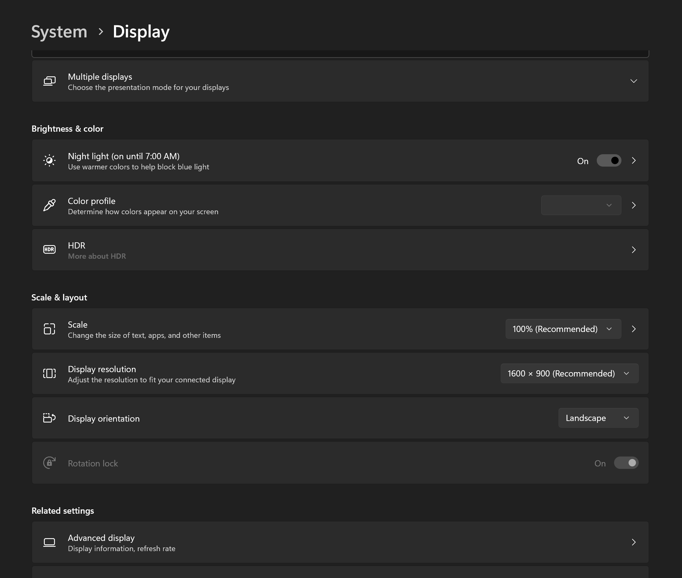

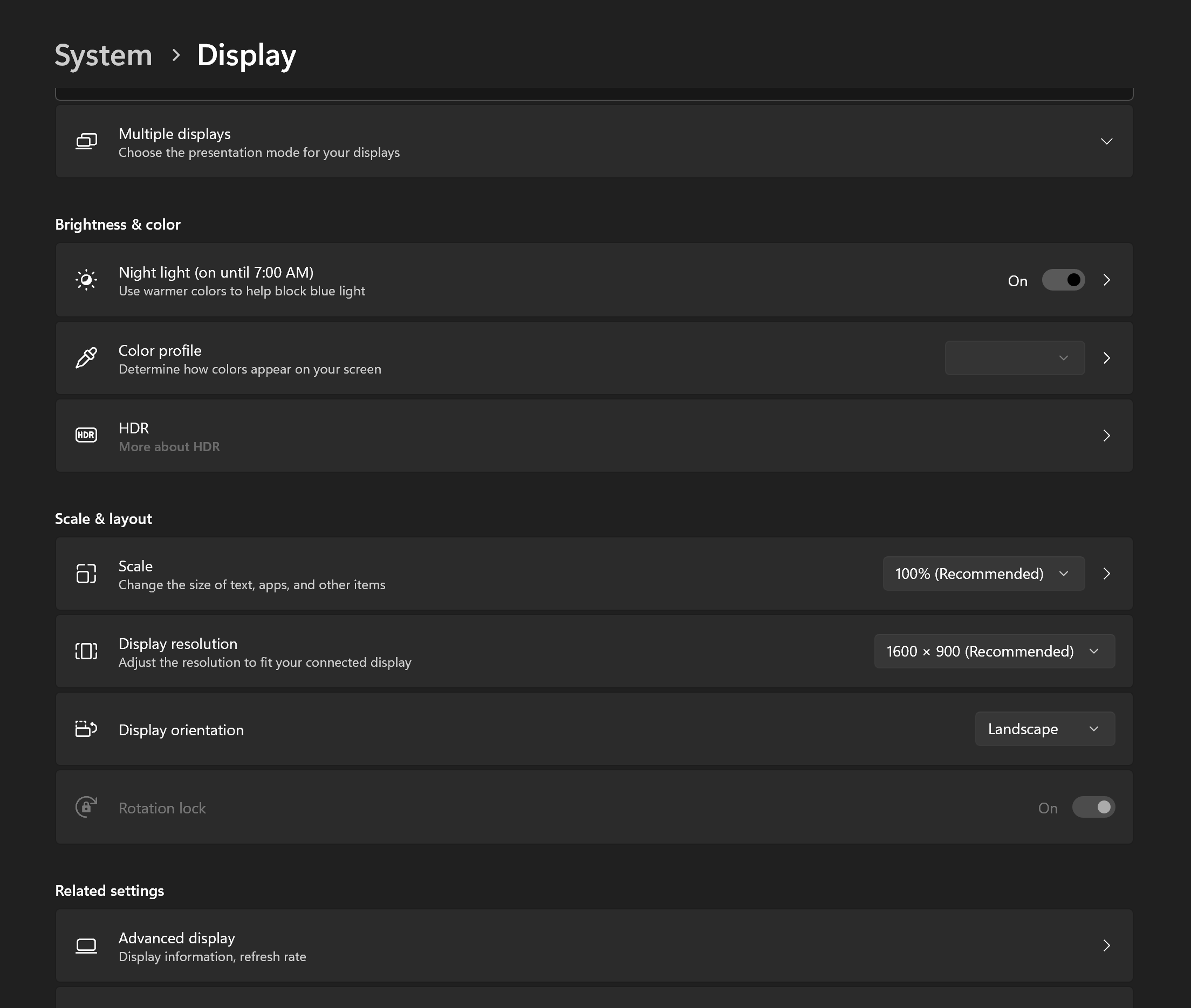

Thanks for your answer. Are you sure about the 100% scaling? The screenshot you have posted earlier does not look like 100% scaling. Please post a screenshot of System > Display page of Windows Settings app.
43,134

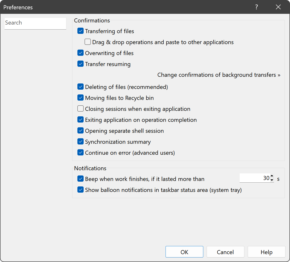

100% scaling preferences window looks like this:
https://winscp.net/eng/data/media/screenshots/pref_environment.png
Your screenshot is more than twice as large.
Isn't the settings your have posted for a different monitor than the one, where you run WinSCP (and where you run the Settings app, as its screenshots is also much larger than 100% scaling)?
Please post a complete desktop (all monitors) screenshot, including both WinSCP and the Settings System > Display windows (with top monitor layout part and scaling settings visible).
