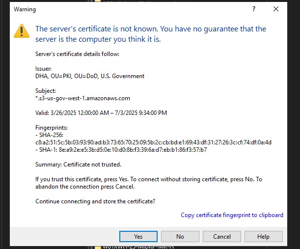

We use WinSCP Portable (of varying versions) to connect to an AWS GovCloud S3 bucket via DoD devices. Initial connection goes fine, but after a variable number of operations (usually file copies) an alert appears for an untrusted connection. The certificate issuer is DHA (Defense Health) which means it's part of DHA's "man in the middle" packet inspection. The problem is selecting "yes" to continue and store the certificate does nothing other than putting the fingerprint in the winscp.ini file. There's just an endless series of those alerts in no discernable pattern which essentially makes WinSCP useless for us.
I've dug around the net and I haven't found anything that applies to bypass that warning using the GUI (vs .NET code). -certificate * looked promising in the .ini (to be narrowed down if that worked), but made no difference, nor did I find anything applicable or germane in the Raw Settings for that session.
Any way out of this? This has put us at a bit of a standstill. Thanks!

See enclosure please, Martin. Clicking "Yes" allows the file copy to go on for a random interval measured in seconds and then the alert presents itself again. Saying "Yes" does nothing...repeatedly; it's never added to the cert store or anywhere, but the fingerprint is added to the winscp.ini. It's hard to say when this problem started as we had a seasonal lull in which we weren't using S3.
Thanks for your attention to this.
