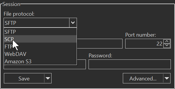

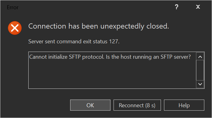

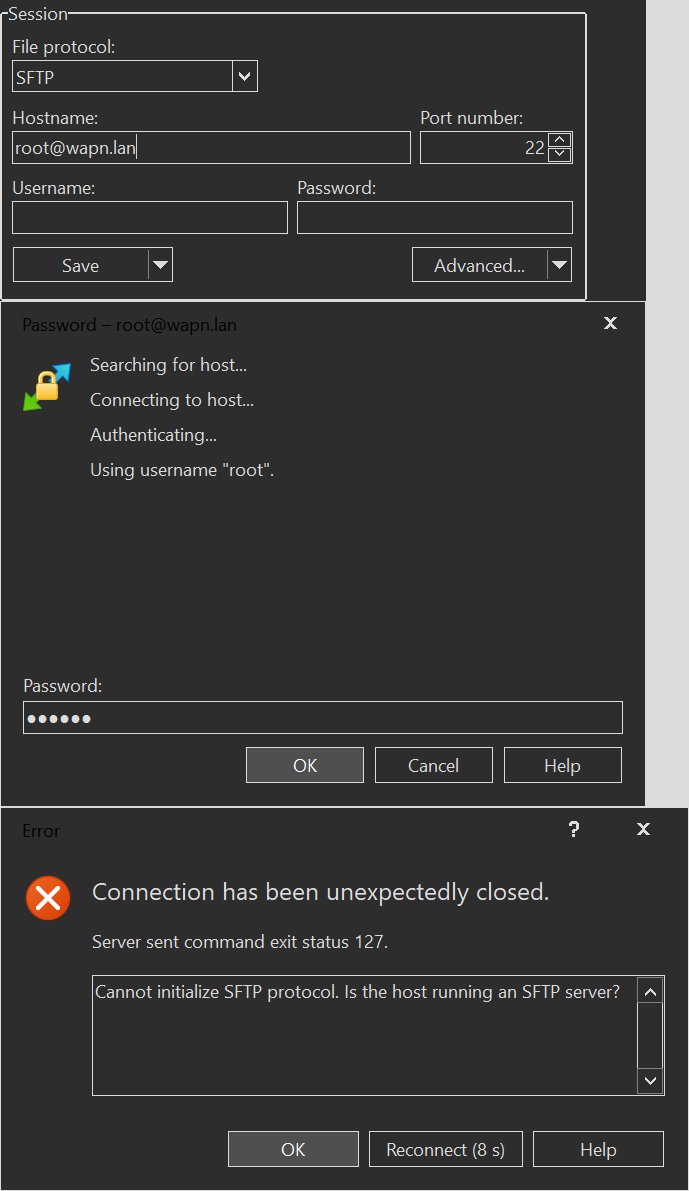

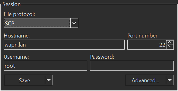

I just discovered I could use WinSCP without installing an SFTP server on my space constrained OpenWRT device.
It took me a really long time to figure this out
I always assumed I needed to install openssh-sftp-server
But all I needed to do was change the protocol to SCP.
I think it would be a nice bit of polish, instead of erroring out, to not error out and work instead by auto trying SCP when SFTP fails. I imagine there's a way to query the server for capability, since that error occurs after the login has completed already.
