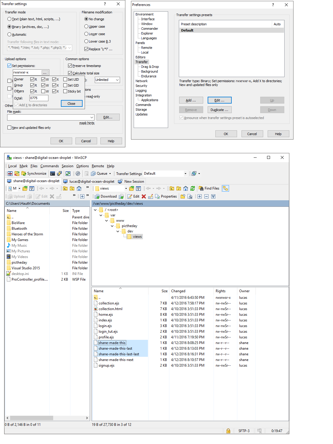

Transfer settings for file permissions
Can't get the Set Permissions checkbox to apply to newly created files. My process is right-click -> new file, ALL of my modes in the Transfer settings are Set Permissions (checked) to 755.
New files do not come in with these changes.
Can't decide if it doesn't work or if I'm not doing it "right".
Step by step what-to-click-when-making-new-file instructions would be appreciated, 'cause I'm unable to get WinSCP settings to function.

Hauthorn05
Intercept
Disregard my post!
I learned the issues are with sftp and not my actions through ftp clients.
