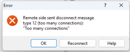

Remote side sent disconnect message type 2 (too many connections): "Too many connections"
The SFTP user frequently getting this error(Remote side sent disconnect message type 2 (too many connections): "Too many connections") while, the SFTP user try to login the SFTP server.
I have validated the user account status, which was enabled.And connection from user system to SFTP server also enabled.
But why the user sometime getting this error, What is the reason behind this error and how it'll resolved.
Please update all in properly.
Description: Error Screenshot.
Re: Remote side sent disconnect message type 2 (too many connections): "Too many connections"
@SP: What is the SSH/SFTP server? How is it configured to limit the connections? What kind of diagnostics does it provide for the problem/tracking connections? Why do you think it is a WinSCP (client) problem?
@Guest: The error comes from the server. So there must be a server-side limit.
