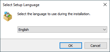

  1. Open the installation program by double clicking on its icon.
  2. Select the language you want to use (both for installation and later when using WinSCP).
