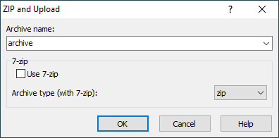

In the Archive name enter a name of the archive (without extension) to create. The option is available when executing the extension only.
When the Use 7-zip is not checked, the extension uses a native .NET framework implementation for a ZIP compression. In this mode, the extension has no additional dependency. Particularly, if you want to use a different archive type, check the Use 7-zip and install the 7-Zip.
When using 7-Zip, you can use the Archive type to select the archive type to create.
Use the 7-zip path to select an alternative path to the 7z.exe or 7za.exe, particularly if you are using a portable version. The option is available on the Preferences dialog only.
In the Session log file you can specify a path to a session log file (for uploading). The option is available on the Preferences dialog only.
