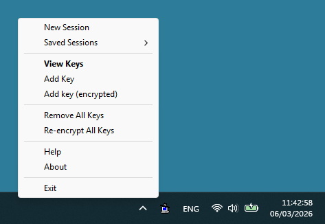

When you run Pageant, it will put an icon of a computer wearing a hat into the System tray. It will then sit and do nothing, until you load a private key into it.

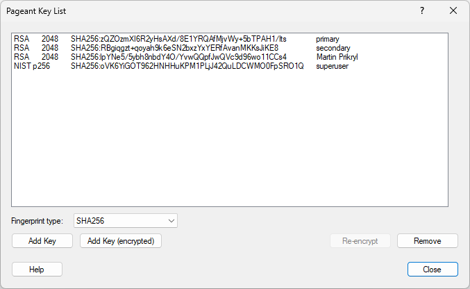

If you click the Pageant icon with the right mouse button, you will see a menu. Select View Keys from this menu. The Pageant main window will appear. (You can also bring this window up by double-clicking on the Pageant icon.)
The Pageant window contains a list box. This shows the private keys Pageant is holding. When you start Pageant, it has no keys, so the list box will be empty. After you add one or more keys, they will show up in the list box.

The Pageant Main Window
The Pageant main window appears when you left-click on the Pageant system tray icon, or alternatively right-click and select View Keys from the menu. You can use it to keep track of what keys are currently loaded into Pageant, and to add new ones or remove the existing keys.
The Key List Box
The large list box in the Pageant main window lists the private keys that are currently loaded into Pageant. The list might look something like this:
ssh-dsa 2048 22:c3:68:3b:09:41:36:c3:39:83:91:ae:71:b2:0f:04 k1
ssh-rsa 2048 74:63:08:82:95:75:e1:7c:33:31:bb:cb:00:c0:89:8b k2
For each key, the list box will tell you:
  • The type of the key. Currently, this can be ssh-rsa (an RSA key for use with the SSH-2 protocol), ssh-dss (a DSA key for use with the SSH-2 protocol), or ssh1 (an RSA key for use with the SSH-1 protocol).
  • The size (in bits) of the key.
  • The fingerprint for the public key. This should be the same fingerprint given by PuTTYgen, and also the same fingerprint shown by remote utilities such as ssh-keygen when applied to your authorized_keys file.
  • The comment attached to the key.

To add a key to Pageant by reading it out of a local disk file, press the Add Key button in the Pageant main window, or alternatively right-click on the Pageant icon in the system tray and select Add Key from there.
