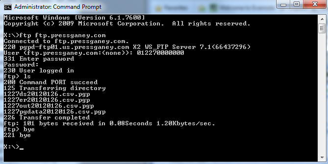

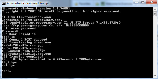

WIndows 7 CMD ling FTP screen shot Attached...

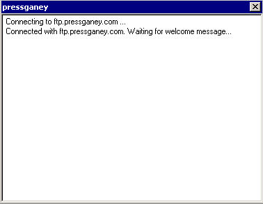

Description: This is the screen shot of the GUI waiting to connect. Then after this it reconnects. This repeats up to 10 ten times before it will eventually connect.

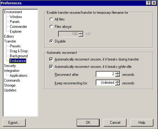

Description: This is the screen shot of the endurance settings for the host I'm trying to connect to.
Description: this is my windows 7 pc FTP screen shot that can conncet immediately to the host.

lravens19
Hey Martin thank you for your response. Are you talking about the endurance settings? Currently "reconnect after" is set to 2 seconds and "Keep reconnecting for" is set to unlimited. Is there another setting you are referring to?
