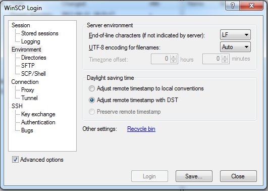

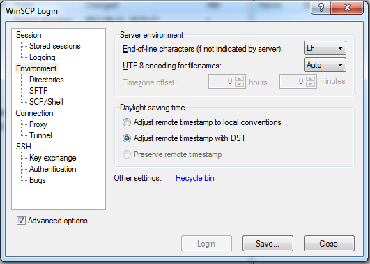

  1. What DST setting are you using in the GUI?

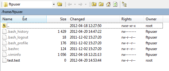

  2. Please post a screenshot of GUI with some test directory as evidence of correct timestamps

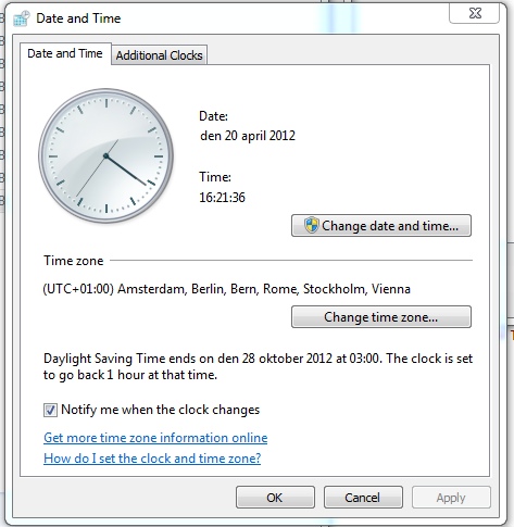

Description: Client time+timezone

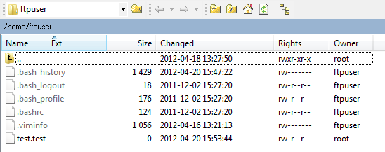

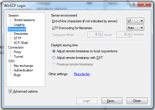

Description: Settings try 1

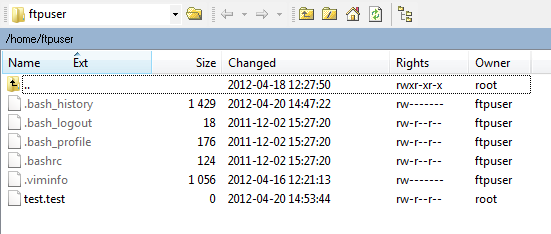

Description: Results try 1
