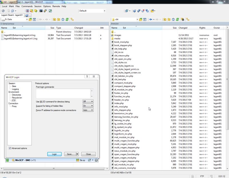

gverhoeven
Re: In 5.2.1 beta it seems that hidden files are not shown
I'm bit lost as I do not see much difference between your two scenarios from your description.
Anyway to comment the log files:
lagant01@elearning.lagant.nl.log: This has MLSD enabled and I can see the.htaccessin the directory listing. So I hope you could see the file in panel for this case
lagant01@elearning.lagant.nl-1.log: This both MLSD disabled and Support for listing of hidden files disabled, as such it does not get.htaccessin the directory listing.
Maybe it was not clear in my comment, but the first listing was to show you that a .htaccess file really exists.
The second file (MLSD disabled) was the one showing that hidden files are not shown even when Support for listing of hidden files is 'On'. You asked me if it was on, and I told you it was. If you can see in the log that it was not on then tell me what I'm doing wrong because the program tells me it is on.
I've added a screenshot showing that it is on and you can see that the listing is not showing the .htaccess file.
Site Admin -
- Joined:
- Posts:
- 43,071
- Location:
- Prague, Czechia
Ok, I see. You are right, it's not working correctly. Thanks for being persistent!
This bug has been added to the tracker:
https://winscp.net/tracker/1015
Petr◆
Moderator -
- Joined:
- Posts:
- 63
Fixed in 5.2.2 beta and released today.
