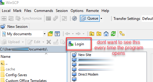

Not seeing how you dont get what several users are asking.
We dont want the login prompt to pop up every single time we open the program.
We dont want to have to close a login box every single time we run the program.
It cant be that difficult to understand this concept.
Yes, you can use "Keep main window open when last session closed" but you still have to close the window every single time because that doesnt stop you from being forced to see a Login box.
This is 2019, not 2009. Be better.
