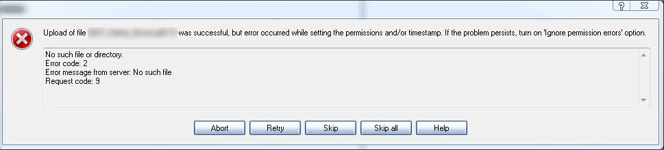

Issue update
Upgraded to latest version of WinSCP and noticed something interesting (while using temp files resume)
After I upload the file it gives me the attached error message
If I click retry it then writes the proper timestamps (!)
I guess you were right, for some reason the server might have gotten the timestamp set command before the temp file been renamed
Description: error image
