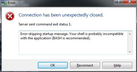

The device I'm connecting to does not have /bin/bash. When I specify /bin/sh in the Advanced Site Settings I get the following error:
Error skipping startup message. Your shell is probably incompatible with the application (BASH is recommended).

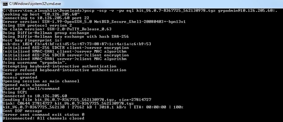

[/img]
Description: Screenshot showing PSCP working to same device.

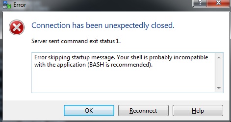

Description: ScreenShot showing error message

c:\Program Files (x86)\PuTTY>pscp c:\upload\fixpool.sh grpadmin@10.126.205.100:.
grpadmin@10.126.205.100's password:
fixpool.sh | 0 kB | 0.8 kB/s | ETA: 00:00:00 | 100%
