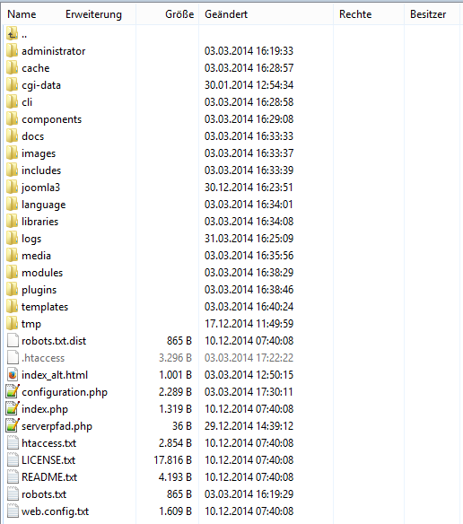

With FileZilla I see the rights on all servers and can change them. With WinSCP I see the rights only on some servers.
I know, that WinSCP can show the rights only, if this feature will be supportet by the server. But why can FileZilla shows the rights in all cases?

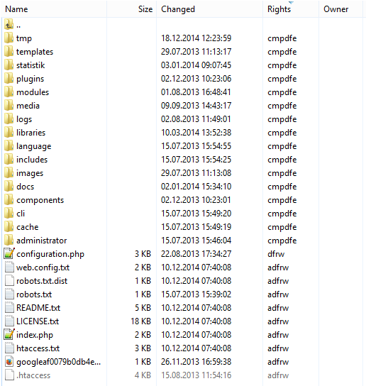

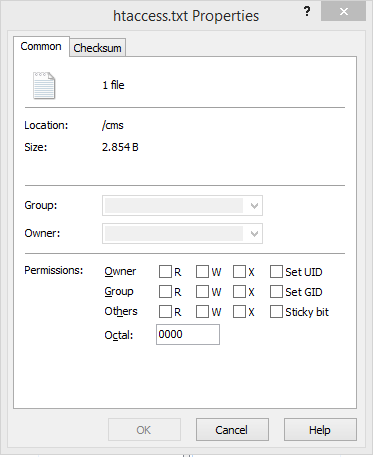

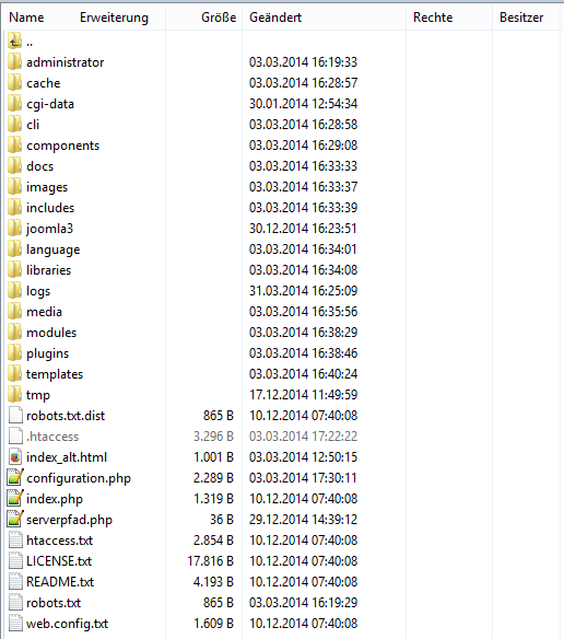

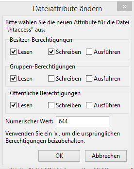

I can't do this, because the problem occours without any operation. For more information see the attached screenshots: After login the columns rights and owner are empty in WinSCP but filled in FileZilla. The same after right click to a file and selecting properties.
The problem occours only on the servers from Strato (<invalid hyperlink removed by admin>).

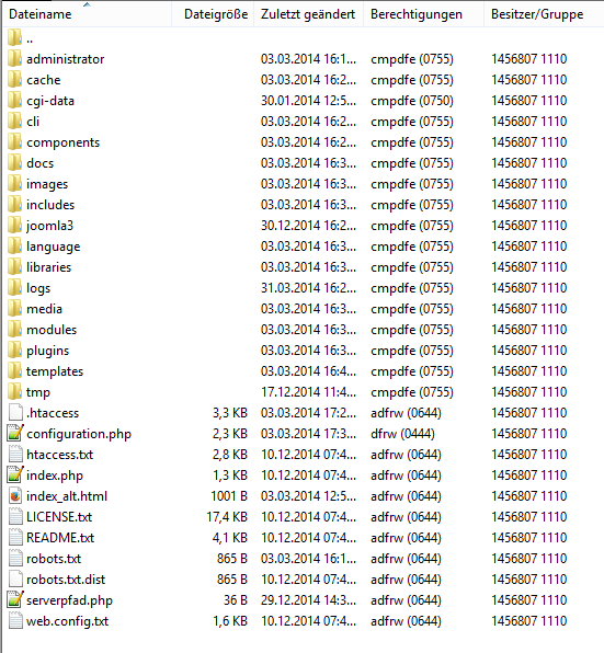

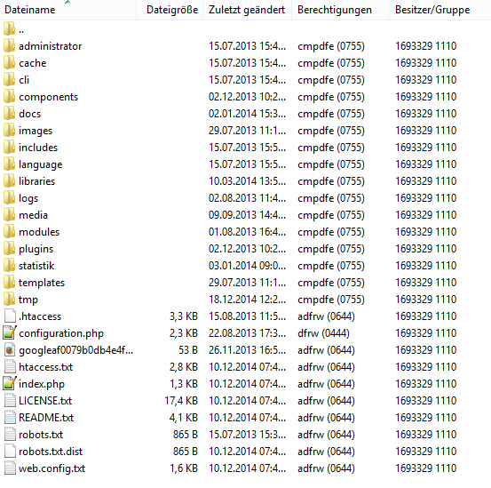

I try it with 5.6.4. Now the rights column isn't empty, but it shows values different from FileZilla or WinSCP at other servers than strato. For example, cmpdfe or adfrw instead of rwxr-xr-x or rw-r--r--
You will find the log attached
