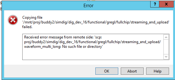

Here is the error, see attached image. I will work on getting a log uploaded. In regards to the version, it looks like I am current.
Description: Screenshot showing failed then looking in the dir you see the file.

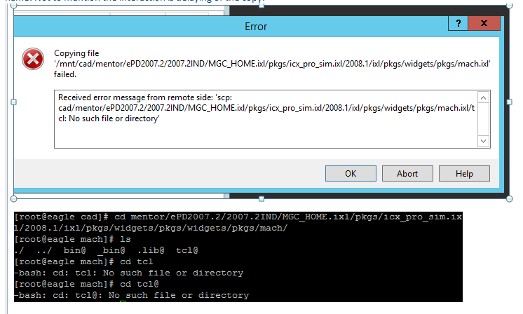

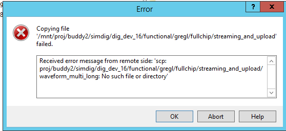

Here is a log and screenshot to go with it.
Description: this corresponds with the log.
  • log.txt (81.68 KB, Private file)
Description: Here is the log to go with the pic.
Re: How to replace trailing character
If you cannot work with the file in shell, it's unlikely you can work with it in WinSCP with SCP protocol. Did you try SFTP?

Isn't there a way to copy\rename on the fly, or exclude "randomnamerandomlength@" so if ends with "@" don't copy or replace it with a valid character?
The problem is about inability to access the remote file, not about an inability to save the file locally with "@" at the end. So there's nothing to rename.
You can exclude them though. Use file mask *@.
See https://winscp.net/eng/docs/file_mask
Why do I get prompted to click OK, at least if that didn't happen I could let the copy run.
Well, because an error occurred. Usually, you want to know that.
