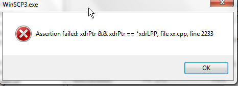

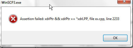

2) I was and always used WinSCP v3.3.0 & v3.7.6 but I recently noticed quite a few posts that pointed to a bug with the earlier version (jpg win3.3.0) therefore I tried the latest WinSCP which did not resolve the Permission denied issue, so I stuck with WinSCP 3.5.5 as quite a few posts and then reply s from the Site Admin prikryl who indicated that this version resolved the error problem way back then.

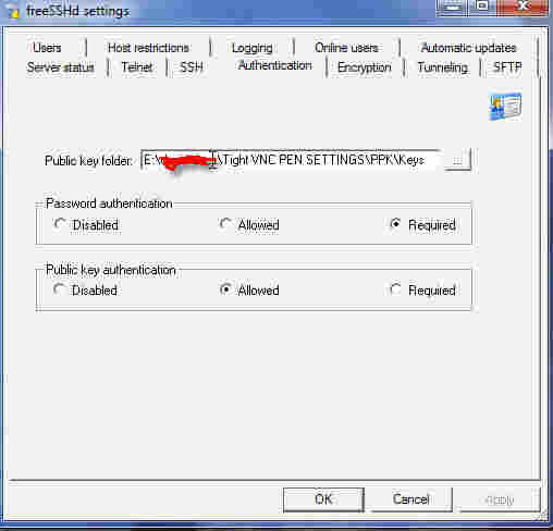

4) FreeSSHd 1.3.1 jpg I am using NT Authentication and have set public key to allowed with Shell, SFTP, and Tunnel all selected.– the key was generated from the putty key generator.

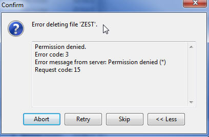

WinSCP Locally I CAN go destination to source copy / delete or move, - but I can NOT go source to destination ans that route give me Permission denied error code 3 ( in short the right hand column is off limits.

Not that I pretend to know what I am looking at but I noticed in the log file this entry CYGWIN_SYSLOG.TXT ?? but I can not see that file or txt when I search for it .. could it be a hang over from my previous Cygwin install that is causing this error ? I may be talking rubbish here so pleaser dismiss it out of hand if you feel the need.

I decided to install WinSCP 5.7.6 on M1 ( the problem machine ) and then tried to login within the machine environment to see if I could trf files and folders within M1, i.e loop login
I have again posted the log files privately ( well I selected private ) M1-xxxxx-loop-121-(1) and M1-xxxxx-loop-121 just in case but I have looked at them before posting
I have also attached 2 jpgs with error messages FYI

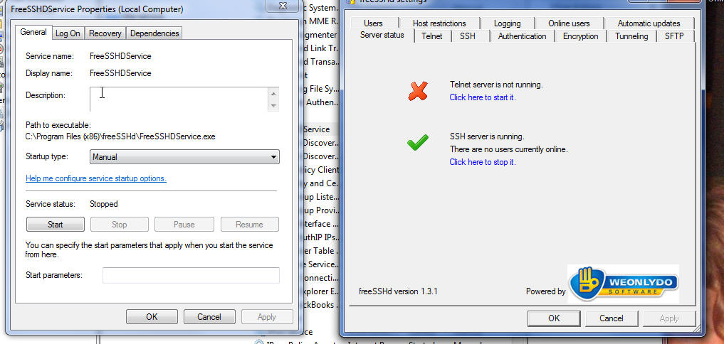

Still struggling with this -- I have just posted a jpg below FreeSSHd service.jpg of the FreeSSHd server set to manual in services tab. along with the application ticked and running .. is this configuration correct ? I think I am clutching at straws now.
