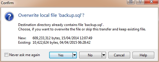

Mmmm weird. I have that ticked, and do get a popup (see attached). But nothing mentioned in there about continuing the download (I'm doing a test 500mb file, which I cancelled part way through, and then tried to restart it)
