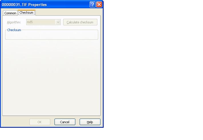

Dear Friends,
unable to check the MD5 check-sum value from check sum tab in file properties, it is in disabled,
can anyone help me out from this issue.
Thanks,
Suresh
Description: Checksum is disabled

You server probably does not support the checksum calculation.
See https://winscp.net/eng/docs/protocols
Please attach a full log file (using the latest version of WinSCP).

As you can see in the FEAT response, your server does not support any of the checksum calculation commands (HASH, XSHA1, XSHA256, XSHA512, MD5, XMD5, XCRC). There's no solution.
