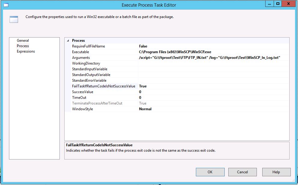

I've stumbled upon a rather annoying and completely baffling issue. I have an Execute Process in SSIS (see attached screenshot) which successfully runs a script file (contents below). The log file confirms that the script is being executed, but is returning a Status Code: 1 and Sending special code: 12 (because there are no files to collect) but the SSIS Execute Process is not returning a failure - it is simply continuing on to the next step (which it shouldn't).
Quote:
option confirm off
open sftp://username:password@serveraddress.com/ -hostkey="ssh-rsa 2048 XXXXXXXXXXXX"
option transfer binary
get "Test_315599340_C*" "g:\ftproot\Test\Customer.txt"
get "Test*_V_*" "g:\ftproot\Test\Transaction.txt"
close
exit

Thanks In Advance,
Nathan
Description: SSIS Screenshot
[View user's profile]
Joined: 2002-12-10
Posts: 25544
Location: Prague, Czechia
The "Status Code: 1" is not an error.
No match for a file mask is not an error either, by default.
To change it, use option failonnomatch on at the beginning of your script.
https://winscp.net/eng/docs/scriptcommand_option
