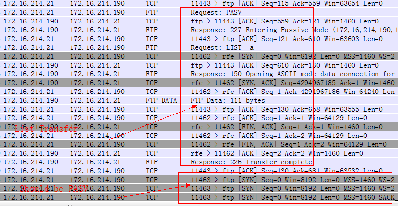

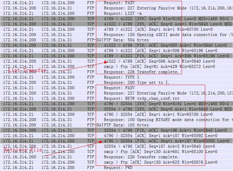

When I use WinSCP to access a UNIX machine by FTP,
file retrieve can be performed normally, start by
a PASV command.
But when I use WinSCP to access my own Embedded
system by FTP, while the list command can be performed
normally but the file retrieve command can not. WinSCP
start to connect the 21(FTP)port through another port
as it already has a control link.In normal procedure,
it should send a PASV command instead of doing that.
Attachments below show the wireshark capture of the
two different behaviors.
I wonder what makes WinSCP do file retrieve in the two
different ways.

Description: File retrieve do not happen
Description: A Normal List & File Retrieve

Here are the Log files and a compressed file of the WireShark capture files.
IP:172.16.214.190 is my own embedded system
IP:172.16.214.200 is a standard UNIX machine
Download without the "transfer in background" option gose well with my system
When the "transfer in background" option is checked, WinSCP start to connect my system port 21 through another port while the control link has already established with port 21.A tcp SYN frame is sent from client machine to my embedded system port 21.
In the log file of the standard UNIX machine, the background transfer also logged that WinSCP connected the machine fist, but I didn't see a tcp SYN frame sent from WinSCP to the machine port 21 in the capture of WireShark.
