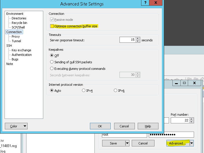

WinSCP slow speed SCP/SFTP – How I fixed it
Hi folks,
old servers I knew were capped at 10Mb/s, so when WinSCP reported 1MB/s I was actually happy with it, so I stopped paying attention to it.
Recently I noticed that even from 1Gb/s and 100Mb/s servers, WinSCP was still downloading at 1MB/s so I got curious and then little frustrated when I noticed culprits were always the same servers, while others ranged from +4.5MB/s.
I changed most relevant settings but the one that actually worked was to disable Connection -> Optimize connection buffer size.
Cheers

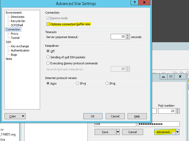

Re: can't find the settintgs
crazyluke wrote:
I have the same problem but can't fix it. Why?
I had some issues finding it as well. On the specific connection click the Advanced button and in the Advanced Site Settings window select Connection.
Under Connection uncheck Optimize connection buffer size.

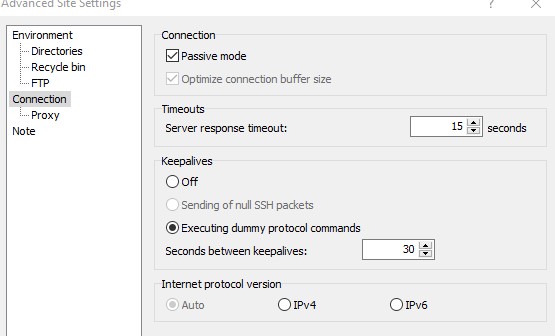

setting for latest version?
where does one find "Connection uncheck Optimize connection buffer size" setting for latest version? there's no connection settings listed on left like in the image?
Re: setting for latest version?
the corey's wrote:
The issue when I do it is that option is greyed out, how do I get passed that part?
The option is mostly relevant for SFTP and SCP protocols only. What protocol are you using?

So I have been using WinSCP (recently paid!) for years and I finally started to wonder why I could download multiple queued files at identical speeds simultaneously.
I turned off "Optimized" in the Connection settings and the downloads, while they were eventually faster, the initial "run up" to the maximum speed was longer.
I read through the FAQ and followed the "raw settings" adjustments. A point to note is that the "Common" settings do not include the SFTPDownloadQueue or SFTPUploadQueue. It would be preferred if they were included in the list of explained options here: https://winscp.net/eng/docs/rawsettings

In which the SFTPDownloadQueue setting is advised to be changed from 4 to 10, so I tried that and the performance was reduced from 3MB to 1.1MB. So that was not a good outcome.
So then I tried changing SFTPDownloadQueue to 50 and was able to achieve as high as 5.8MB/s
