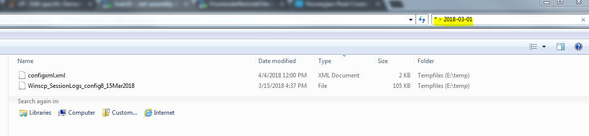

Anyways, for filtering files in File Explorer, just enter the condition in the search. I have attached a screenshot.
