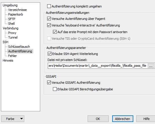

see the settings that i ahve opened on the old machine - the notebook that i have used for many years.
now - the issue is that i cannot port over the credentials ot the new notebook.... something is missing.......
see here the settings...:
erweiterte einstellungen fr Verbindungsziele
authentifizierungsparameter
erlaube ssh agent weiterleitung
datei mit privatem schluessel
C:\Users\Heike\Documents\martin\_data__export\filezilla_\filezilla_pass_file
question : what does the file does - it is a filezilla_pass_file!?

btw: giess
my SFTP server requires Public key authentication in addition to the password.
The old system had the key saved, either in FileZilla or in the system's SSH agent. This type of key is not saved in filezilla.xml but elsewhere. While Windows uses the Registry for the SFTP keys, Linux surely uses some kind of flat file.
well - dear Martin i guess that i need to salvage the key from the old system and transfer it to the new one, or, alternatively, re-obtain it from the server administrator.

many thanks - i will do as adviced - and i will copy the file.
btw: Where to put the file to. do i have to put this private key file to a certain place.
is there a certain process to _add_ this file to a path where the protocoll
a. can find it
b. will call it
note: The reported issue with the error (guess number 2) talks about paths that cannotbe found. guess that i have to clear up these things too.
