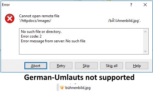

I want synchronize remote to local. Winscp 5.13.4 on Windows 10 (1803 Build 17134.254) with SFTP.
Messagebox said remote file can't open, but its exists and is workable.
UPDATE:
I have seen, that files with German-Umlauts was downloading, so Umlauts is workable but I must actual hundreds times confirm to skip, but the file exists on remote side.

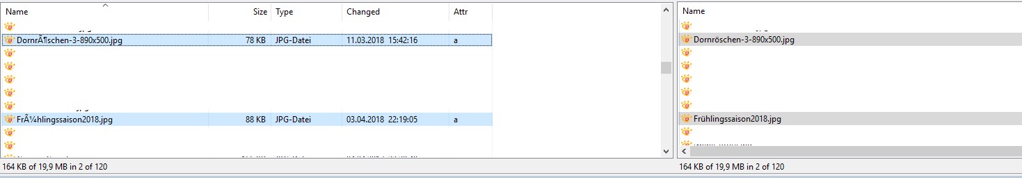

Here a first test with winscp dev version 8773
With this version files with "umlauts" are transfered, but the filename is now damaged.
See the attachment.
I can copy with F5 or drag&drop and filename is fine, but synchronize make here a problem.

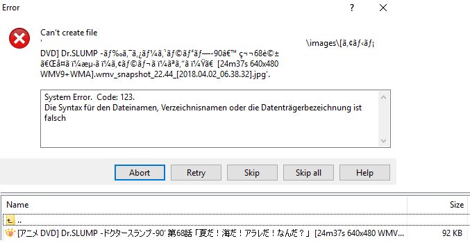

Here a remote file with japanese characters exists on server and can transfer with F5 or drag&drop without any problem, but with synchronize its failed to create.
See attachment.
filename: [アニメ DVD] Dr.SLUMP -ドクタースランプ-90’ 第68話 「夏だ!海だ!アラレだ!なんだ?」 [24m37s 640x480 WMV9+WMA].wmv_snapshot_22.44_[2018.04.02_06.38.32].jpg

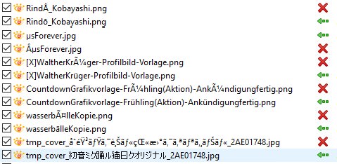

I have synchronize a very small part of last sync (two days ago; folder have 129.074 files, 25.606 folders and size of 2,25 GB), with the same dev build. This time its show me the wrong files last time created to replace with correct file names.
43,136
Waruwaru wrote:
I have synchronize a very small part of last sync (two days ago; folder have 129.074 files, 25.606 folders and size of 2,25 GB), with the same dev build. This time its show me the wrong files last time created to replace with correct file names:
