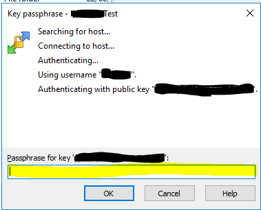

How did you "entered the PrivateKeyPassphrase property in WINSCP GUI to test connection using GUI"?
Re: error in generated c# code (mistake between Password and PrivateKeyPassphrase)
during connection phase in GUI, a progess window is displayed.
Once authentication is addressed, the progress stops and I'm invited to enter passphrase in a popup.
ps this SFTP connection requires username and private key, no password is used.
[img][/img]
Description: screenshot login window
