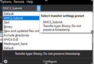

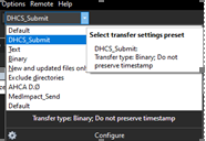

yeah, I've not been able to catch it, but I'm asking two questions
1) Default profile, |Preferences |Transfer |Default, how to bind the setting under default that was defined under the Site to the Site when connecting/ed ?
2) I've seen this error somewhere on the interweb for winSCP, it's either trying to set/preserve the time stamp or set permissions and the problem only occurs when I connect to one site; which I cannot test; so once a month I submit two files and get this error and each time I try different setting for the 2nd file, but to wit not been able to resolve.
43,035
Are you looking for this?
https://winscp.net/eng/docs/transfer_settings#presets
This one?
https://winscp.net/eng/docs/message_preserve_time_perm
