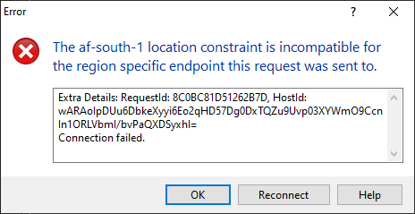

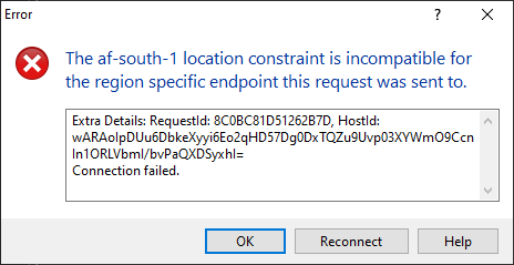

WinSCP Error Message when attempting to connect to an S3 bucket in the new af-south-1 location:
The af-south-1 location constraint is incompatible for the region specific endpoint this request was sent to.
Screenshot of error dialog attached.
Description: ScreenShot of Error Dialog
