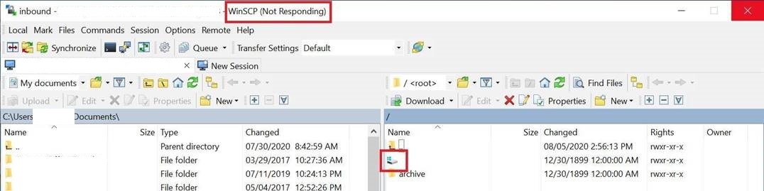

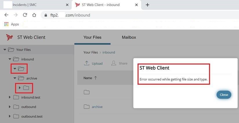

When we access SFTP using WinSCP and access a folder which has a subfolder that appears to have no name, WinSCP freezes and needs to be closed through the Task Manager. Also the dates look to be incorrect in WinSCP. See attached screenshots.
Version 5.17.6 (Build 10516)

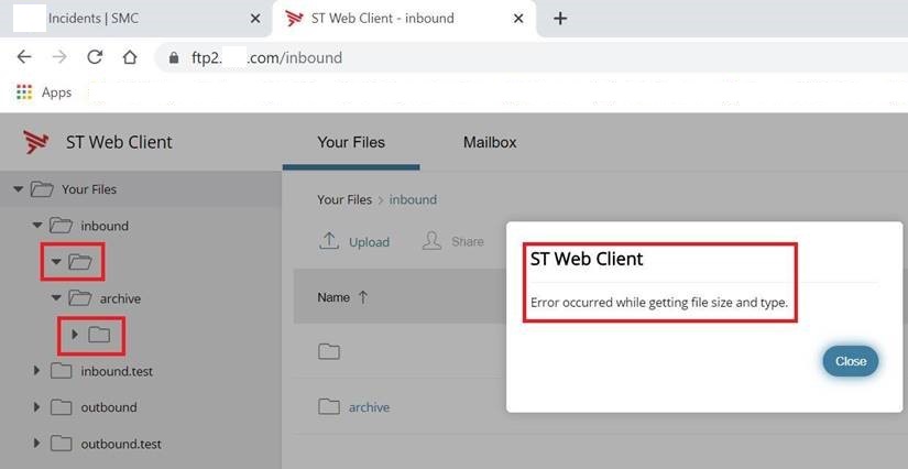

Description: When we access the same FTP folder in a browser we get an error but can continue browsing in FTP

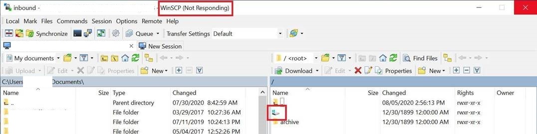

Description: When we access the same FTP folder in WinSCP the application hangs. Also the dates look really strange (but that's not really relevant).

Just to be clear, when the specific files / folders without name are removed the issue no longer occurs. We have tested this, so it's definately a WinSCP issue. I'm just wondering why this causes WinSCP to crash and not just show an error like the webbrowser does.

Willem
5
Hello Martin.
Our FTP admins have resolved the issue on Friday so I was not able to run WinSCP debug version while the problem existed. They reported the FTP job would create an "Archive" folder with a leading "space" in it (" Archive"). This caused WinSCP to hang. Hope this helps and thanks for your time.
