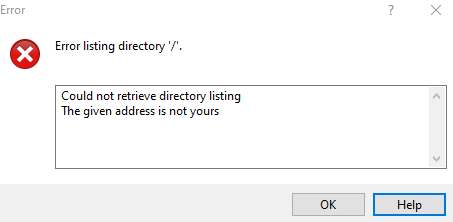

So I'm having an issue with WinSCP.
I'm using version 5.17.8
I connect using FTP and it starts to login, but then it shows an error message saying "The given address is not yours" and nothing shows up in the connected window.

That's a message coming from your FTP server.
Googling the message, I found this:
https://web.archive.org/web/20181017144948/http://community.linksys.com/t5/Network-Storage/NAS200-FTP-server-says-quot-The-given-address-is-not-yours-quot/td-p/274889
Can you login with any other FTP client?
If you want us to investigate further, please attach a full session log file showing the problem (using the latest version of WinSCP).
CamTheCoolKid
The FTP host just enabled passive mode, I can log in now using passive mode.
I'm not sure how to get a full log file.
