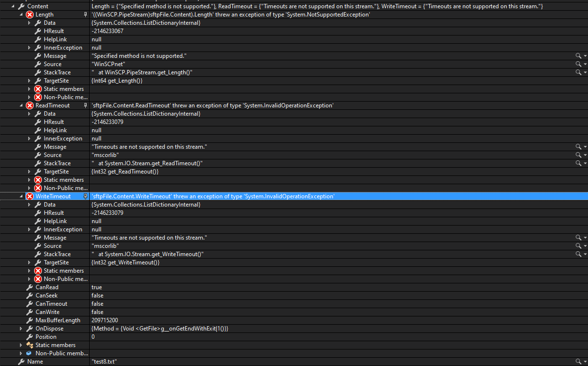

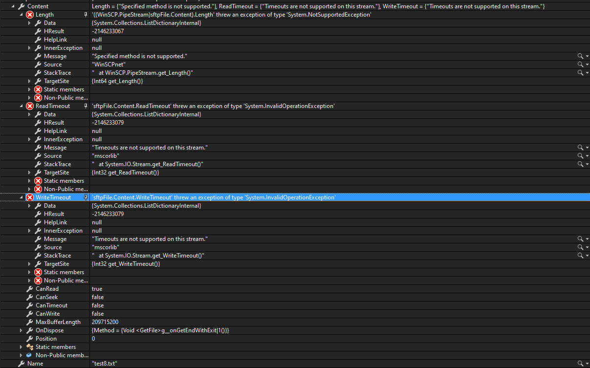

I'm using the WinSCP 5.18.2-beta Version and I want to download a file via SFTP protocol to stream.
For .NET Standard 2.0 as well as for .NET Framework I´m getting the same errors.
After calling
session.GetFile the stream has errors you can see in the attached file StreamErrors.PNG.
Than after calling
session.Close the following exception is thrown:
The code I´m using is the following:Exception:
System.InvalidOperationException: 'Recursive calls not allowed'
