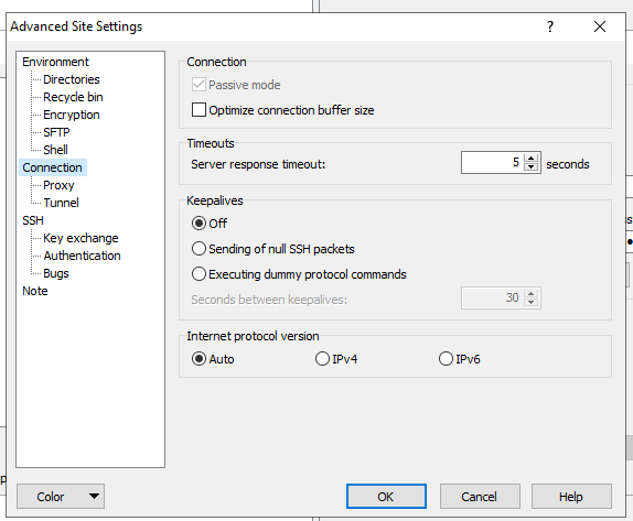

Thank you for your response Martin
"Optimize connection buffer size" was already unchecked

Description: WinSCP Connection Settings
