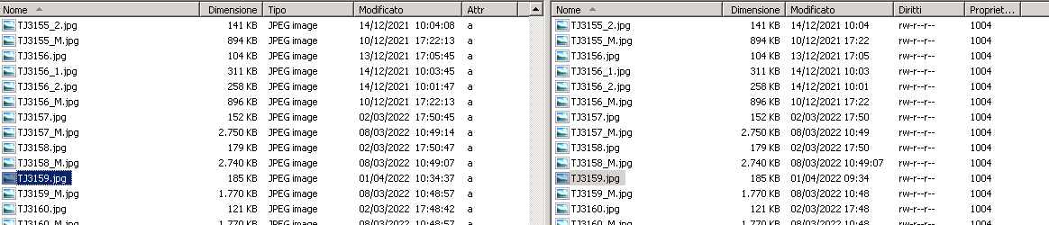

Hi, I don't know why, but for some transferred file from local to remote, either manually and by sync script, the file time changes, and some other times the seconds are added, but most of the times not. The strange fact is that this happens only for some file, really few, and working with synchronization by date and size, this means that some file are always transferred.
I've added a screenshot, so you can see this, and as you can see, it happens only for few files (every time the same files).
Thanks
