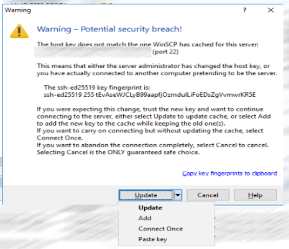

I realize this is not a new subject, but the previous post(s) I've seen on the subject didn't answer my specific problem. I'm hoping that this isn't a MitM attack, but it could be.
Error after the "Warning" is "The server's host key does not match the one WinSCP has in cache..." and I'm given the option to Update, Add, Skip, or Cancel. I did "Skip" two times and was able to get on to the server and everything looked fine, but I'm concerned that I'm passing sensitive information when I use that option.
For some more detail, my server is hosted on AWS with load balancers and an RSA key-pair. However, the error message states "The new ED25519 key details are:...". I'm no security expert, but I believe ED25519 is a completely different protocol from RSA, which makes me think there is something nefarious going on.

I assume that the RSA key that you refer to is the one you authenticate with. That's different key than the host key.
See Understanding SSH Key Pairs.
If you have multiple SSH servers behind a load balancer, use Add button to cache keys of individual servers one-by-one.

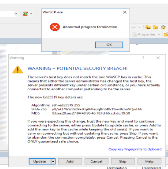

I have the same issue with another one (6.1.1 – SFTP – Abnormal program termination).
Each issue appearing randomly from time to time and both (I have to move big data and don't watch process all the time, but when I check progress I see one of this issue or both).
It appearing both on 6.1.1 and 6.2 beta.

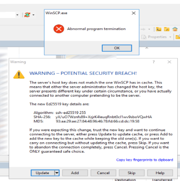

On the source side I have Windows Server 2019 std eng and on destination side – rhel x86_64 8.7 w/o any LB & NAT (connection from source to destination is through L2 network).
Screenshots of errors attached.
If it isn't possible to fix this issues is it possible to add option "Always Add" or "Always Update" for workaround of this issue?
