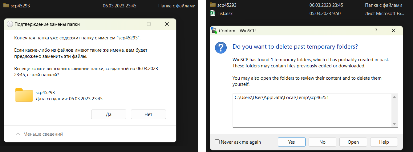

If I copy from the server (FTP, SFTP) and paste the file on the disk via the clipboard, I get an empty folder. If, after that, I press Paste (Ctrl+V) again, I get a message about the merge folders, as if this folder was already in the clipboard (Image 1).
If I repeat Ctrl+C on the file from the server, and then Ctrl+V in target folder again, I will receive the file (List.xlsx). But when I restart WinSCP, I will be prompted to delete another temporary folder (Image 2).

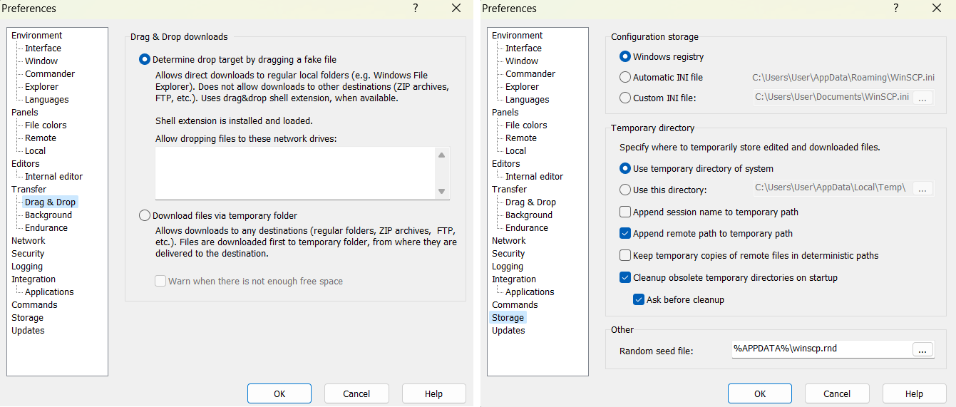

Changing "Append session name to temporary path" does not affect the error.
