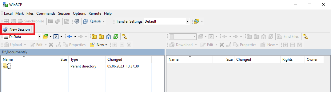

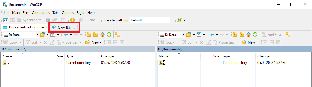

@Ibiza69: I'm sorry, but you didn't explain the different that you perceive. How is the connection menu more difficult to find than before?
I assume you have "Show Login dialog on startup and when the last session is closed" preference option turned off (otherwise I guess you would not even be asking). The option is enabled by default btw. You must have turned it off. If you use WinSCP only for connections, you might want to restore it.
Anyway, in case you want to keep the option off: Attached are screenshots of 5.21.8 and 6.1 with all defaults, just the mentioned option off (or after closing the initial Login dialog). Can you please explain how is the "connection menu" more difficult to find? Is it the label? ("New Tab" vs. "New Session"?)

And about the update, if you see in both screecaptures you shared, in v5 it was more easy and intuitive to connect, in v6 this changes a lot and it was pretty difficult to find it, so maybe you can valorate on bringing to front again so brings back the easy of use of your great program. Thank you!
Re: Show Login dialog on startup and when the last session is closed
All tabbed interfaces I know (most web browsers for example) have "New Tab" on the right.
