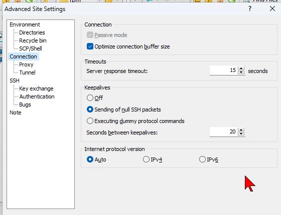

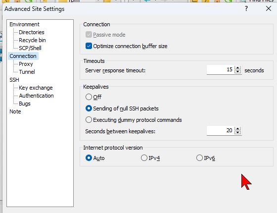

Hi thanx for your answer:
yes, I had found this already,
and this is/was my current setting:
Description: screnshot
i ll set it to xecuting dummy commands, now, just to try again.

Hello again, and thanx for the reply.
I just realized that the actual problem occurs when my internet gets disconnected or when I change between VPN and no-VPN, etc. etc. – then there's seems to be no automatic reconnect in the background. While as you correctly mention it keep the active connection alive with the setting/s you suggested. This works fine, while I wont change networks, which I do many times/day for many reasons :D
Is there a way to reconnect automatically sessions in the background (regularly I got up to 7 tabs open) that have been disconnected due to change of network? Maybe this option already exists?
This manual reconnecting is really a pain,...
Thanx for your answer!! :)
