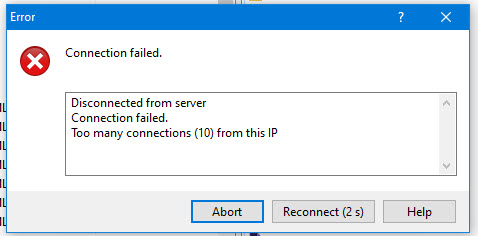

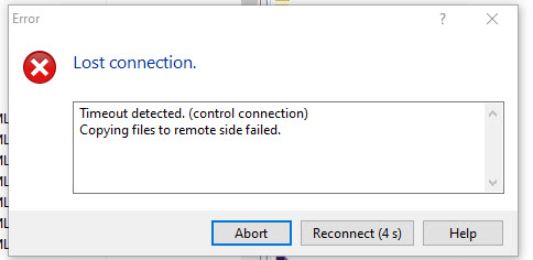

Running WinSCP. Have problem with copying files to remote server. I had an older version which has the problem, so I upgraded to 6.1.2 and still have same problem.
I have a website and am trying to copy a directory of approx. 500 files to it. I use WinSCP, connect to the server, and drag and drop from left to right. The copying starts, but then after some number of files get copied (between 5 and 20), the connection fails saying "Lost Connection - Timeout detected." So I hit the reconnect button. It reconnects and again the same scenario...some files get copied, and then disconnects. Then, after 10 reconnects, I get a window saying "Disconnected from server. Connection failed. Too many connections (10) from this IP." And it will then not allow a reconnect till the next day.
Is this a problem with my system? Or the internet? Or the server? How to tell? ... and how to fix? Note: I have not problem with the browser getting to this website, and any other website.

I am having a similar problem, but only in the last week. One afternoon FTP went from working perfectly to a numerous time out problem. Sometimes the file was transferred OK, sometimes not. It seems to have improved a bit, but there is still frequent timeouts. Sometimes it timesout and reconnects within a few seconds of logging in, with zero other action after starting WinSCP.
I asked my host server people about it, and they looked in the log and said this: "Starting at timestamp 17:56:22, the previously-successful logins went to a series of timeout errors. This implies that your FTP client is successfully logging in, then the server doesn't receive a followup packet from your FTP client before the timeout limit is reached. Which FTP client are you using?"
I am using WinSCP 6.1..2, and am wondering if it made some timeout change recently?
