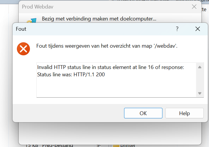

Hi all,
Trying to connect to a WebDAV server, but I get this error message:
Invalid HTTP status line in status element at line 10 of response:
Status line was: HTTP/1.1 200
How can I solve this?

@huemanTX: Thanks. It's due to this change in the neon library:
https://github.com/notroj/neon/commit/b132c8377200e7ea76364125aff43e79f475e6b1
It's bit of a gray zone. The status response HTTP/1.1 200 without "reason phrase" does not strictly conform to the HTTP 9112. Which, while does not require the "reason phrase" as such, requires a space after the "status code". What your server's response lacks.
https://www.rfc-editor.org/info/rfc9112/#name-status-line
Anyway, I understand that it is a regression and I'll look into it.
What WebDAV server is that?

Hello Martin. Thanks for the reply. New log file attached. I'm not certain about the WebDAV server. These are vendor hosted connections. Running Apache Tomcat in AWS. I can forward this information on to them.

I have multiple clients that can not connect due to the same error. Is there a specific WinSCP release in which this will be resolved?
Re: same error
If you follow the thread and tracker link above, you will see that this has been fixed already and the fix will be included in upcoming WinSCP 6.5.1. Meanwhile, you can downgrade to 6.3.8.
