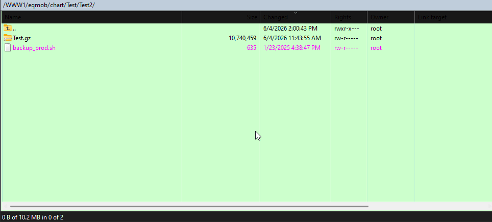

As per the subject,
When the file was accidentally renamed to “.”, the current directory was forcibly removed.
Tested on a few servers.
Current WinSCP version: 6.5.6
