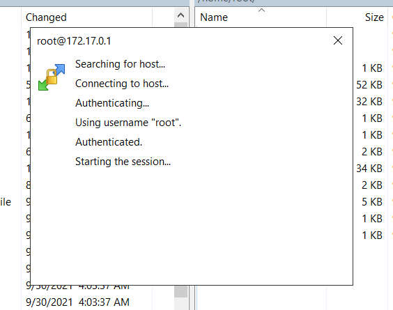

Stuck at "Starting the session". Please help
yellow1912
I can use PuTTY just fine, but when I try to use WinSCP to connect to my server, the program stops at "Starting the session" and just hangs there forever. I tried to login other servers just fine.
Any suggestion is really appreciated since I'm a Linux newbie.

My WinSCP session was stuck at "starting a session". The issue I had was in the .bashrc file I had a command to sudo to another user. Once I removed this line, WinSCP worked. So please make sure .bashrc doesn't have sudo or cd to a directory that has no permission for the user.
sridevi
Facing starting the session stuck issue with WinSCP terminal
When trying to open WinSCP terminal the terminal is stuck at starting the session line and not proceeding further. Please help to resolve this error
TheG
NetScaler specific setting
Was having this problem too with ADC/NetScaler – even though has worked in the past fine on countless upgrades and worked on another NetScaler fine on the same day.
Took a while to figure out – but I had to go into the "Raw Site Settings" in the Advanced drop down while configuring the initial connection. Then Add button -> select Shell from the list, type shell – as the Shell to use (since this is the first command to enter in NetScaler when ssh to the appliance).
Hope this helps someone.
