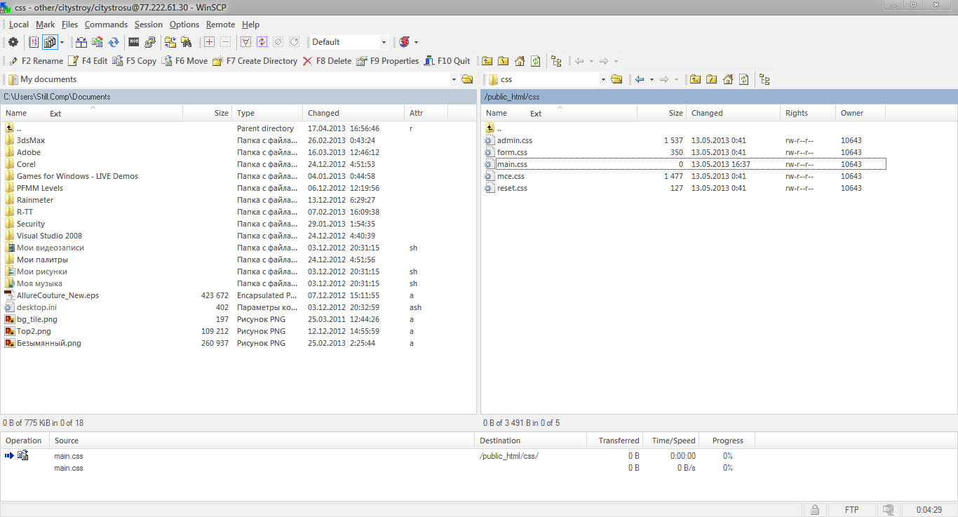

I want to save file form text-editor, or upload direct from left panel and i got a 0% infinite uploading file. When i reconnect file on the host is empty :(
I update WinSCP to last version, but the problem remains.
the problem persists with other hosters. In the panel, these files are tranferred well.

Yes. This problem occurs intermittently and include regular upload or save from editor.
The only solution I've found - to change the file and save as long as the load does not go(google translate =\ )
But this solution does not always work
