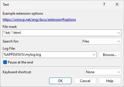

For example the following entries:
# @option - -config label "Example extension options" # @option - -config link https://winscp.net/eng/docs/extension#options # @option Mask -config textbox "&File mask" "*.txt; *.html" # @option SearchType -config dropdownlist "Search for:" -files ^ # -files="Files" -dirs="Directories" -both="Files and Directories" # @option LogFile -config file "&Log File:" "%APPDATA%\mylog.log" # @option Pause -config checkbox "&Pause at the end" -pause -pause
Produce this options dialog:
When the option names are used in a command like:
example.exe -Mask="%Mask%" %SearchType% -Log="%LogFile%" %Pause%
The resulting command (with the options configured as shown on the screenshot, i.e. with the default values) will be:
example.exe -Mask="*.txt; *.html" -files -Log="C:\Users\username\AppData\Roaming\mylog.log" -pause
