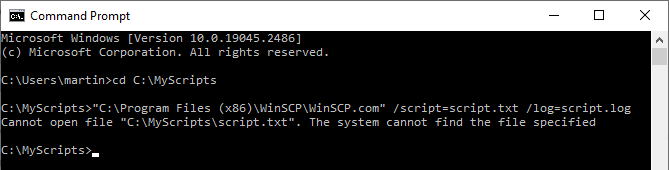

- If no session log is created, chances are that some error prevented WinSCP from starting, creating a log, or starting a session. Check WinSCP console output for any error. It is recommended to execute
winscp.comfrom an existing console window (such as from Windows Command Prompt –cmd.exeor PowerShell).
Thewinscp.cominherits the console1 and when it exits with an error, the error is preserved on the console, allowing you to inspect it. - See also Debugging transfer task running in Windows Scheduler, SSIS, or another automation service or
