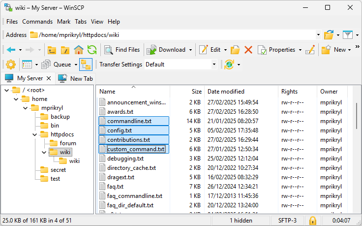

Main Window (Explorer Interface)
With Explorer interface WinSCP looks similar to a normal Microsoft Windows folder (Windows Explorer). Unlike with Commander interface, only remote directory is shown. To transfer the files you typically use drag&drop between WinSCP and Windows Explorer.
Learn if this interface is appropriate for your needs.
Screen Components
The screen of the interface has several components. Some of them are hidden by default. They are (from the top to the bottom):
- Main toolbar with the main menu and address bar.
- Session tabs.
- File panel with directory tree on the left.
- Background transfer queue list (hidden by default).
- Status line.
You can show/hide most of these components from the View menu or using context menus.
Using the Interface
As the interface can be used in the same way as Windows Explorer, you should probably be able to start using it straight away.
