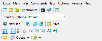

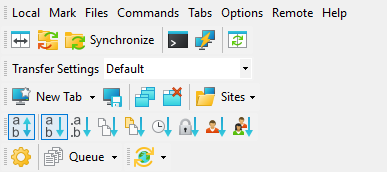

For example see some of the toolbars of the Commander interface.

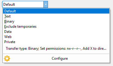

Transfer Settings presets
On Transfer Settings toolbar you can override default transfer settings by selecting one of the configured presets. Note that the first option Default represents default transfer settings.
