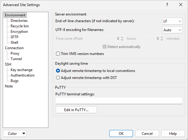

Environment Tab
Environment tab allows user to configure WinSCP adaptation for particular server/environment.
More environment options are available on subtabs:

Server EOL Characters
To allow text mode transfers, WinSCP needs to know what format of text file does the server use. Generally there is plenty of text file formats, almost every platform has it own format. WinSCP supports two most used formats, Unix and Windows. As most SSH servers are run on Unix system, generally you may leave the default Unix format. If your server runs on Windows, select the Windows format. If you do not use text mode transfers, the option is not important for you.
With SFTP protocol version 4 and newer, the server tells itself what format it uses, so the configured option is not used.
Daylight Saving Time
Some servers (mostly on Windows) adjust file timestamp with start of DST and some not (Unix). The option selects between the two approaches. For backward compatibility, Windows-style approach (server does adjustment) is selected by default, while the Unix-style is probably the correct one.
Change the option if timestamps of some files, either in directory listing or after transfer, are shifted by one hour. Note that the option must be set correctly before transferring the files. It does not make sense to try to use it to adjust the incorrect timestamp of already transfered file.
If you are using SCP protocol and the timestamps of all files are shifted by the same time span, it can be also caused by difference between server timezone and UTC. You can counterweight the Server timezone offset difference on SCP tab.
