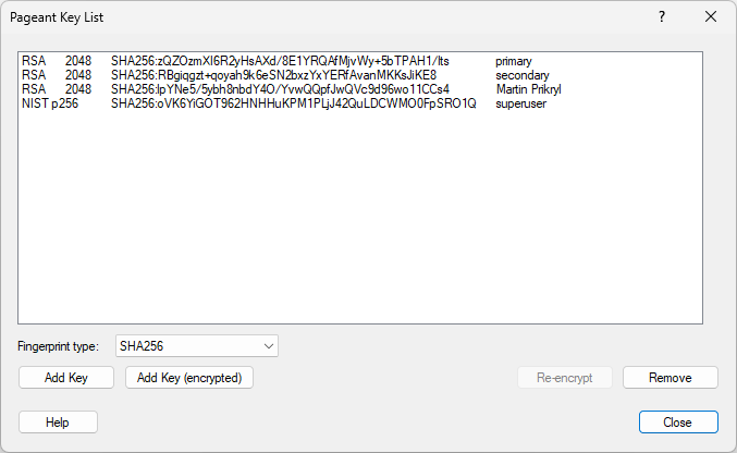

The Pageant Main Window
The Pageant main window appears when you left-click on the Pageant system tray icon, or alternatively right-click and select View Keys from the menu. You can use it to keep track of what keys are currently loaded into Pageant, and to add new ones or remove the existing keys.
The Key List Box
The large list box in the Pageant main window lists the private keys that are currently loaded into Pageant. The list might look something like this:
ssh-rsa 2048 22:d6:69:c9:22:51:ac:cb:b9:15:67:47:f7:65:6d:d7 k1 ssh-dss 2048 e4:6c:69:f3:4f:fc:cf:fc:96:c0:88:34:a7:1e:59:d7 k2
