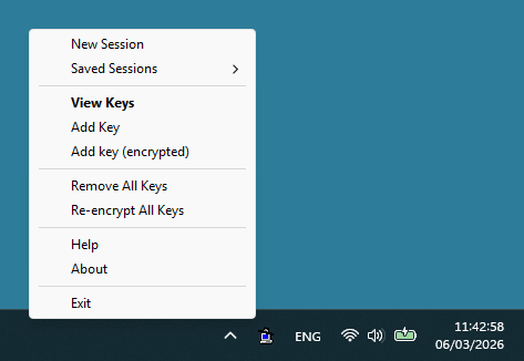

When you run Pageant, it will put an icon of a computer wearing a hat into the System tray. It will then sit and do nothing, until you load a private key into it. (You may need to use Windows’ Show hidden icons arrow to see the Pageant icon.)
If you click the Pageant icon with the right mouse button, you will see a menu. Select View Keys from this menu. The Pageant main window will appear. (You can also bring this window up by double-clicking on the Pageant icon.)
The Pageant window contains a list box. This shows the private keys Pageant is holding. When you start Pageant, it has no keys, so the list box will be empty. After you add one or more keys, they will show up in the list box.
To add a key to Pageant, press the Add Key button. Pageant will bring up a file dialog, labelled Select Private Key File. Find your private key file in this dialog, and press Open.
Pageant will now load the private key. If the key is protected by a passphrase, Pageant will ask you to type the passphrase. When the key has been loaded, it will appear in the list in the Pageant window.
Now start WinSCP and open an SSH session to a site that accepts your key. WinSCP will notice that Pageant is running, retrieve the key automatically from Pageant, and use it to authenticate. You can now open as many WinSCP sessions as you like without having to type your passphrase again.
WinSCP can be configured not to try to use Pageant, but it will try by default.
When you want to shut down Pageant, click the right button on the Pageant icon in the System tray, and select Exit from the menu. Closing the Pageant main window does not shut down Pageant.
If you want Pageant to stay running but forget all the keys it has acquired, select Remove All Keys from the System tray menu.

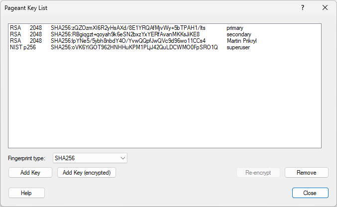

The Pageant Main Window
The Pageant main window appears when you left-click on the Pageant system tray icon, or alternatively right-click and select View Keys from the menu. You can use it to keep track of what keys are currently loaded into Pageant, and to add new ones or remove the existing keys.
The Key List Box
The large list box in the Pageant main window lists the private keys that are currently loaded into Pageant. The list might look something like this:
ssh-ed25519 SHA256:TddlQk20DVs4LRcAsIfDN9pInKpY06D+h4kSHwWAj4w ssh-rsa 2048 SHA256:8DFtyHm3kQihgy52nzX96qMcEVOq7/yJmmwQQhBWYFg
For each key, the list box will tell you:
- The type of the key. Currently, this can be
ssh-rsa
(an RSA key for use with the SSH-2 protocol),ssh-dss
(a DSA key for use with the SSH-2 protocol),ecdsa-sha2-*
(an ECDSA key for use with the SSH-2 protocol),ssh-ed25519
(an Ed25519 key for use with the SSH-2 protocol),ssh-ed448
(an Ed448 key for use with the SSH-2 protocol), orssh1
(an RSA key for use with the SSH-1 protocol, not supported by WinSCP). - The size (in bits) of the key, for key types that come in different sizes.
- The fingerprint for the public key. This should be the same fingerprint given by PuTTYgen, and also the same fingerprint shown by remote utilities such as
ssh-keygen
when applied to yourauthorized_keys
file.
By default this is shown in the SHA-256 format. You can change to the older MD5 format (which looks likeaa:bb:cc:…
) with the Fingerprint type drop-down, but bear in mind that this format is less secure and should be avoided for comparison purposes where possible. - The comment attached to the key.
- The state of deferred decryption, if enabled for this key.

To add a key to Pageant in this encrypted form, press the Add Key (encrypted) button in the Pageant main window, or alternatively right-click on the Pageant icon in the system tray and select Add Key (encrypted) from there. Pageant will bring up a file dialog, in just the same way as it would for the plain Add Key button. But it won’t ask for a passphrase. Instead, the key will be listed in the main window with (encrypted) after it.

You can also ‘re-encrypt’ all keys that were added encrypted by choosing Re-encrypt All Keys from the System tray menu. (Note that this does not discard cleartext keys that were not previously added encrypted!)
