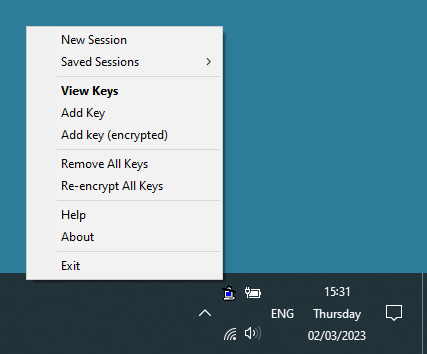

When you run Pageant, it will put an icon of a computer wearing a hat into the System tray. It will then sit and do nothing, until you load a private key into it. (You may need to use Windows’ Show hidden icons arrow to see the Pageant icon.)
If you click the Pageant icon with the right mouse button, you will see a menu. Select View Keys from this menu. The Pageant main window will appear. (You can also bring this window up by double-clicking on the Pageant icon.)

When you want to shut down Pageant, click the right button on the Pageant icon in the System tray, and select Exit from the menu. Closing the Pageant main window does not shut down Pageant.
If you want Pageant to stay running but forget all the keys it has acquired, select Remove All Keys from the System tray menu.

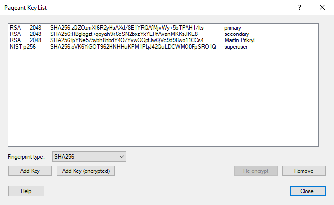

The Key List Box
The large list box in the Pageant main window lists the private keys that are currently loaded into Pageant. The list might look something like this:
ssh-ed25519  SHA256:TddlQk20DVs4LRcAsIfDN9pInKpY06D+h4kSHwWAj4w
ssh-rsa 2048 SHA256:8DFtyHm3kQihgy52nzX96qMcEVOq7/yJmmwQQhBWYFg
For each key, the list box will tell you:
  • The type of the key. Currently, this can be ssh-rsa (an RSA key), ssh-dss (a DSA key), ecdsa-sha2-* (an ECDSA key), ssh-ed25519 (an Ed25519 key), ssh-ed448 (an Ed448 key), or ssh1 (an RSA key for use with the deprecated SSH-1 protocol, not supported by WinSCP).
  • The size (in bits) of the key, for key types that come in different sizes.
  • The fingerprint for the public key. This should be the same fingerprint given by PuTTYgen, and also the same fingerprint shown by remote utilities such as ssh-keygen when applied to your authorized_keys file.
    By default this is shown in the SHA-256 format. You can change to the older MD5 format (which looks like aa:bb:cc:…) with the Fingerprint type drop-down, but bear in mind that this format is less secure and should be avoided for comparison purposes where possible.
  • The comment attached to the key.
  • The state of deferred decryption, if enabled for this key.
The Add Key Button
To add a key to Pageant by reading it out of a local disk file, press the Add Key button in the Pageant main window, or alternatively right-click on the Pageant icon in the system tray and select Add Key from there.
Pageant will bring up a file dialog, labelled Select Private Key File. Find your private key file in this dialog, and press Open. If you want to add more than one key at once, you can select multiple files using Shift+click (to select several adjacent files) or Ctrl+click (to select non-adjacent files).
Pageant will now load the private key(s). If a key is protected by a passphrase, Pageant will ask you to type the passphrase.

The Remove Key button
If you need to remove a key from Pageant, select that key in the list box, and press the Remove Key button. Pageant will remove the key from its memory.
You can apply this to keys you added using the Add Key button, or to keys you added remotely using agent forwarding (see section 9.4); it makes no difference.

To add a key to Pageant in this encrypted form, press the Add Key (encrypted) button in the Pageant main window, or alternatively right-click on the Pageant icon in the system tray and select Add Key (encrypted) from there. Pageant will bring up a file dialog, in just the same way as it would for the plain Add Key button. But it won’t ask for a passphrase. Instead, the key will be listed in the main window with (encrypted) after it.
To start Pageant up in the first place with encrypted keys loaded into it, you can use the --encrypted option on the command line. For example:
"C:\Program Files (x86)\WinSCP\PuTTY\pageant.exe" --encrypted d:\main.ppk
After a key has been decrypted for the first use, it remains decrypted, so that it can be used again. The main window will list the key with (re-encryptable) after it. You can revert it to the previous state, where a passphrase is required, using the Re-encrypt button in the Pageant main window.
You can also ‘re-encrypt’ all keys that were added encrypted by choosing Re-encrypt All Keys from the System tray menu. (Note that this does not discard cleartext keys that were not previously added encrypted!)
